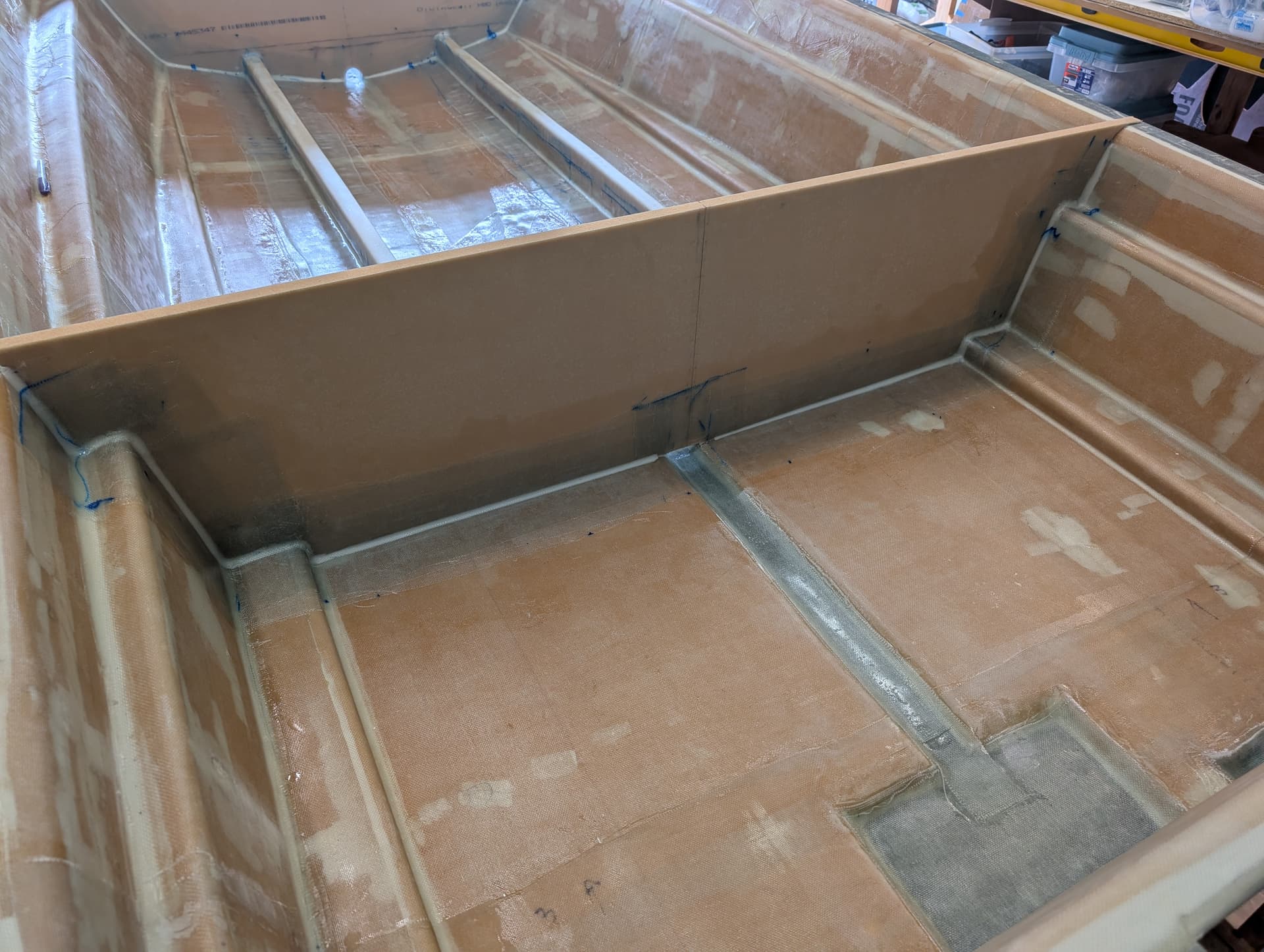

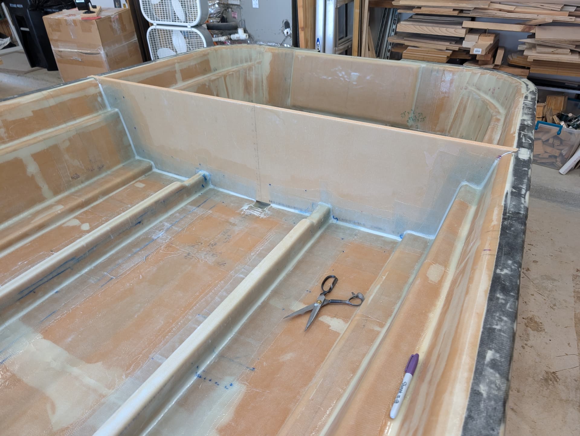

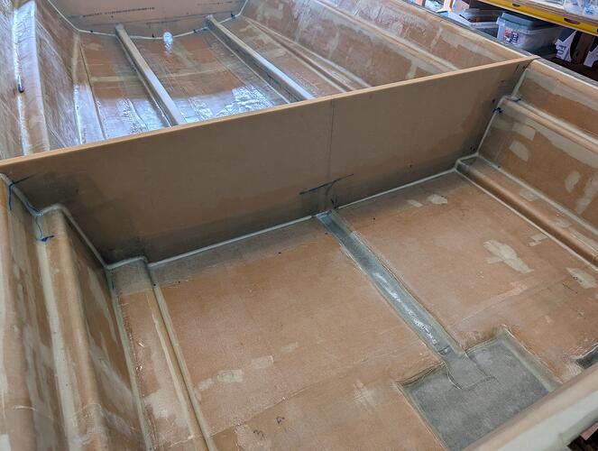

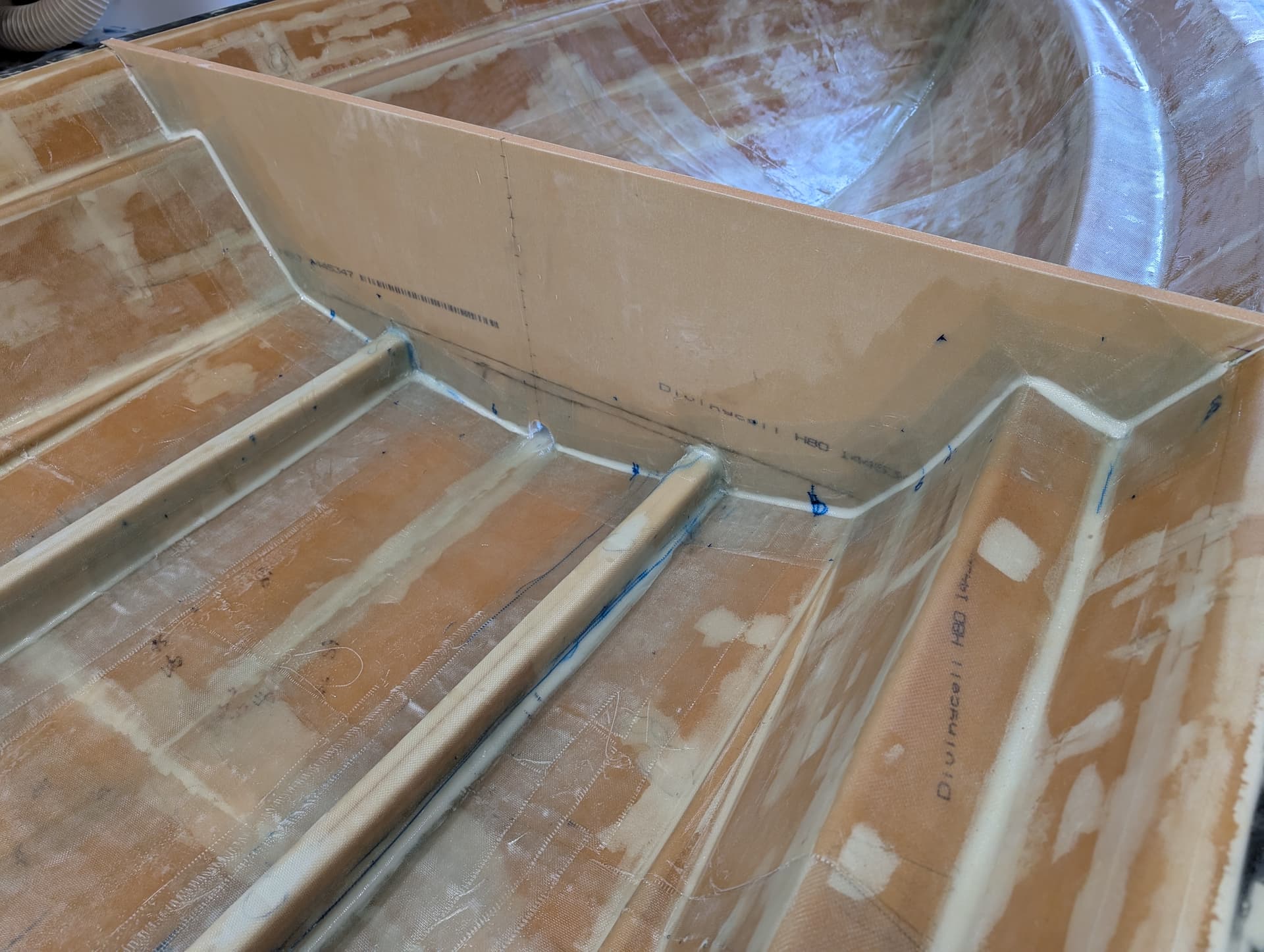

Bulkheads fully glassed in. Perfect weather and temps to work with epoxy resin. I used progressively narrow strips, starting with ~8 inches and then cut to length right on the boat. With scissors, I cut darts in the corners of the cloth to help it all lay down smooth…no need to rush.

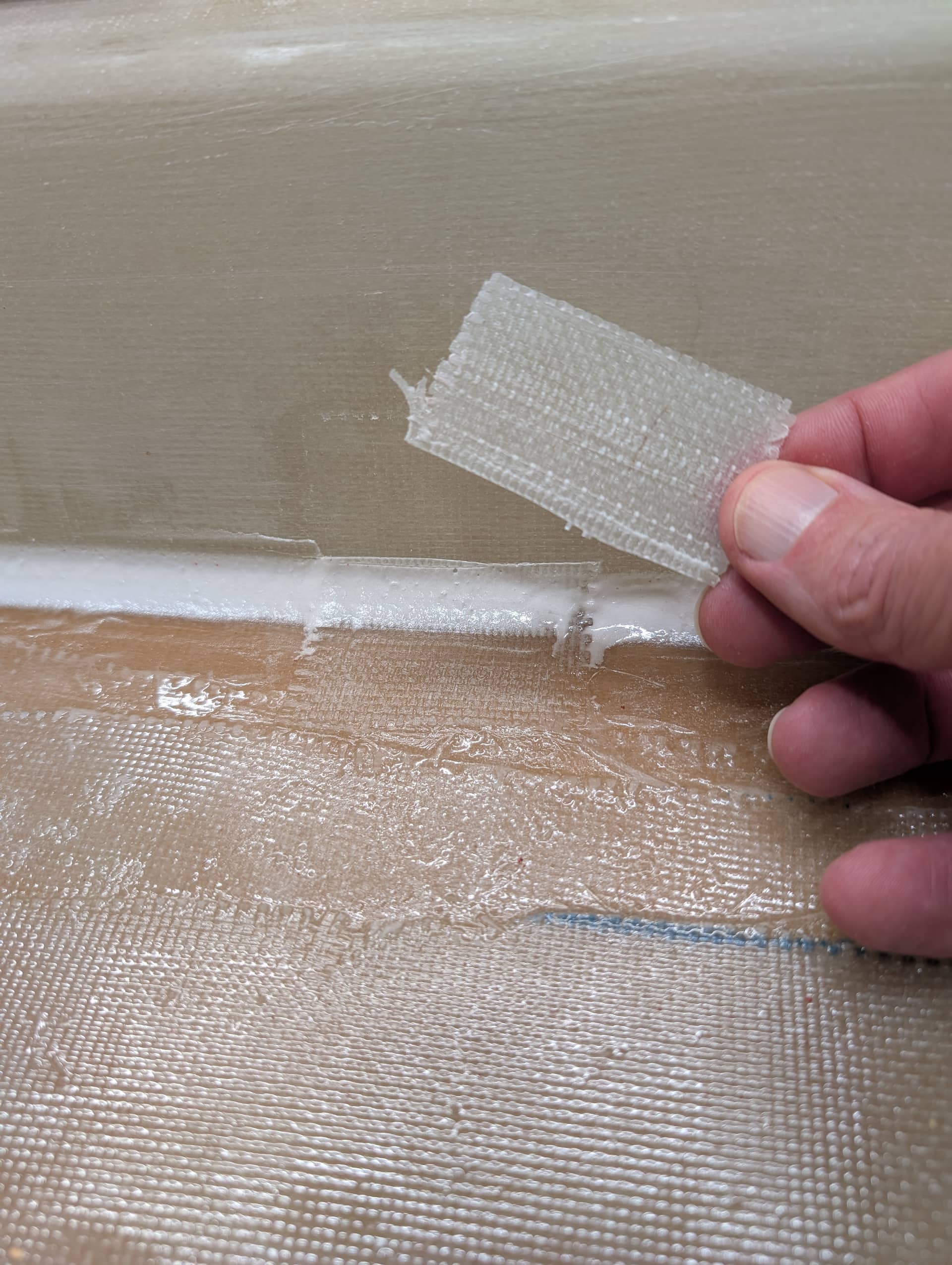

Here’s an interesting update! I had a great plan but I executed it poorly. I figured since I’m making all of these posts, it would be good for me to show my errors/setbacks so others may learn.

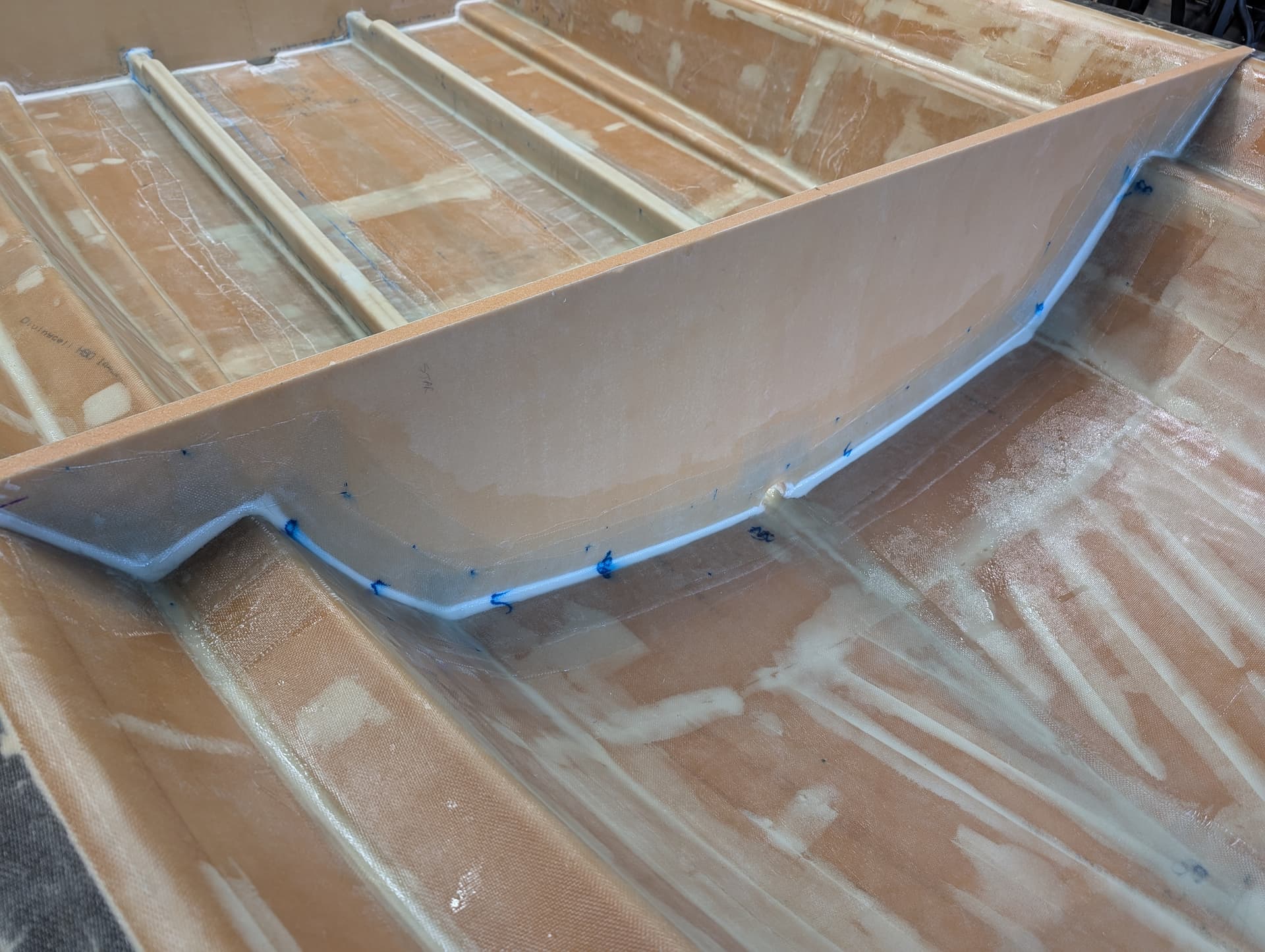

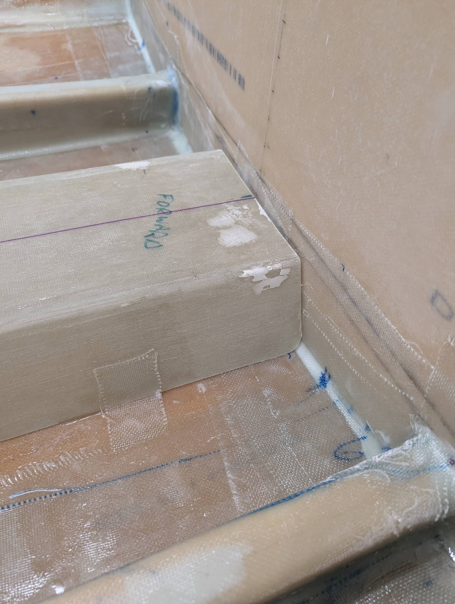

I tabbed in the keel box with small squares, about 5 on each side. When the epoxy cured, I added the fillets with the plan to add three layers of cloth all the way around to weld the box fully in place.
After the fillet was placed and cured, I felt something was not right about the small tabs and pushed on the box and it immediately delaminated. I did the same to the others and they did the same. I pushed near the base near the fillets…popped right off.
Dang…I thought I cleaned all of the wax mold release off…nope.

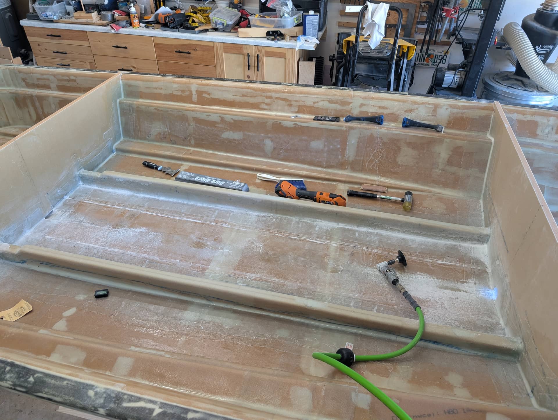

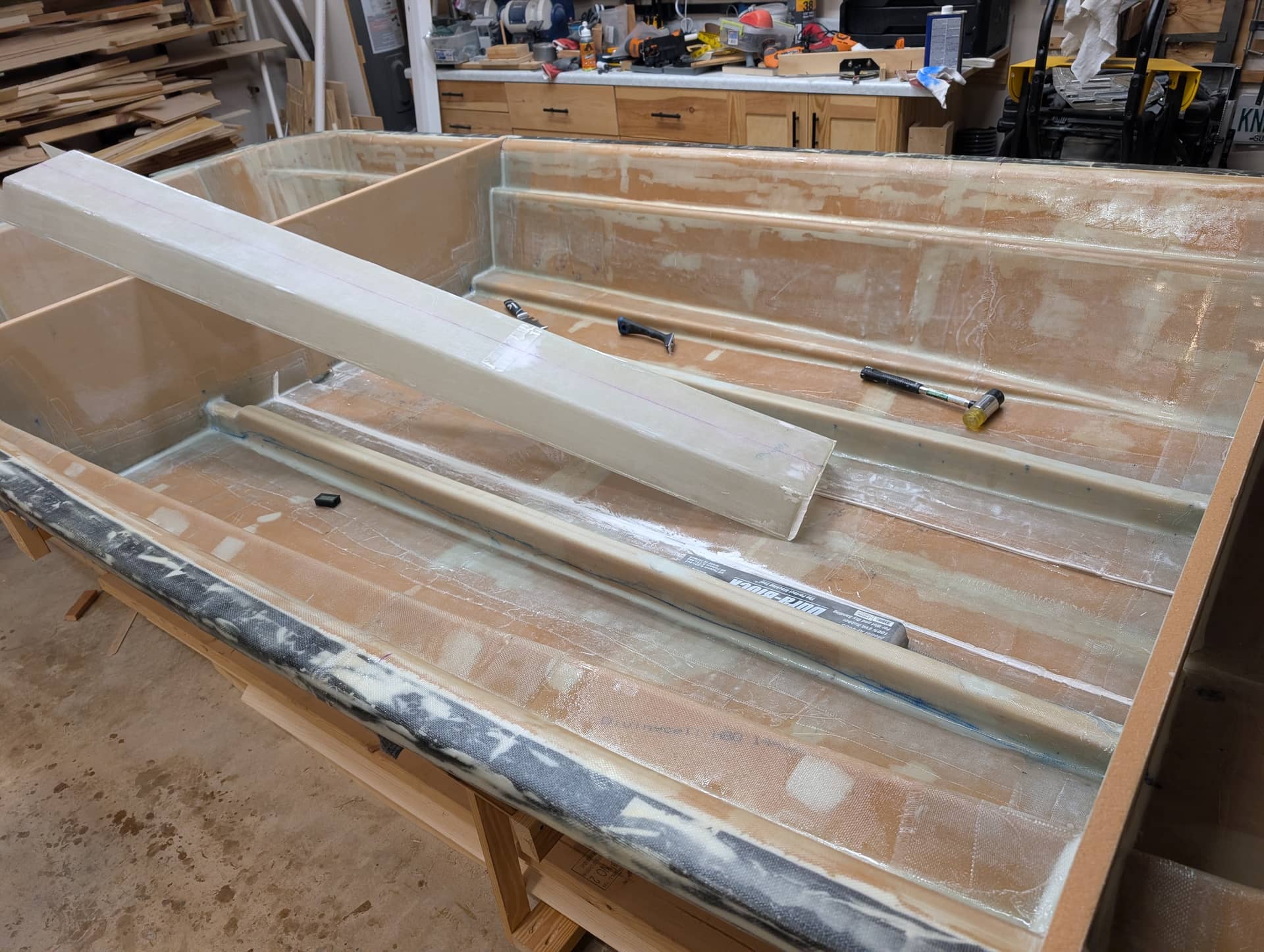

I pulled the box out and removed all of the putty that had cured. Scraper and grinder works great; just took my time.

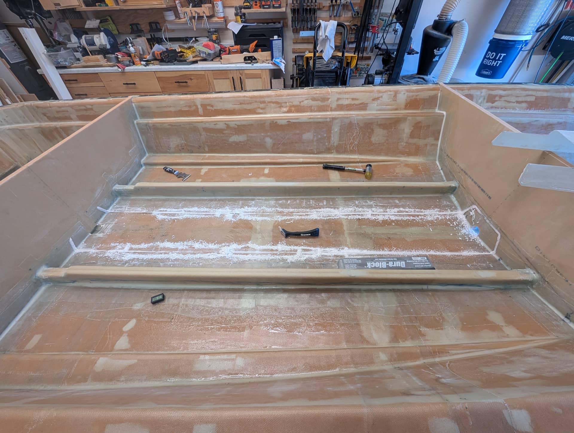

I worked on the box today and thoroughly scuffed the hell out of it. I hand scrubbed it with simple green and also sanded one more time by hand with a 40 grit. Totally different and as it should have been when I tried to epoxy in place last week.
I’ll wipe it all down with acetone or ethanol before trying again. Weather is nice, I might just clean up my garage today and get better organized :rofl: May go fishing tomorrow :smiling_face_with_sunglasses:
