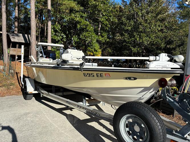

My old Maverick might come close… It was the first smaller Maverick they ever built (before the Master Angler series). They took the 18’ mold, shortened it at the transom 14" and set it up with no inner liner (you saved 100 to 150 doing without the inner liner) - but is every bit of 84" wide like the original 18. We fish it in rivers, along the coast, and everywhere in between. You can pole it, but will have to work at it unless you’re going downwind or down current.. With hard chines and a bit of freeboard it’s surprisingly versatile. That might be why I’m still in it - all these years since 1988…
Being the opposite of a purist it’s set up to fish tarpon (and everything else..) any way you choose from fly to live bait…
Yup, was thinking I found the perfect solution for you, @Brandon - no, she’s not for sale - go find your own!
All teasing aside, she does get a little hull slap at times, so that might be a problem

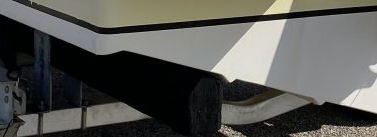

Reverse chines in rear half of the hull, under the waterline off-plane, for lift and tight turning ability , but not too wide (pounding in a chop). Reverse chines should soften and fade away going forward, for zero hull-slap. Lifting strakes, also on rear half of hull bottom, also designed for grip in turns - more triangular, less horizontal (not zero degree - flat). See picture of chine and strakes example.
