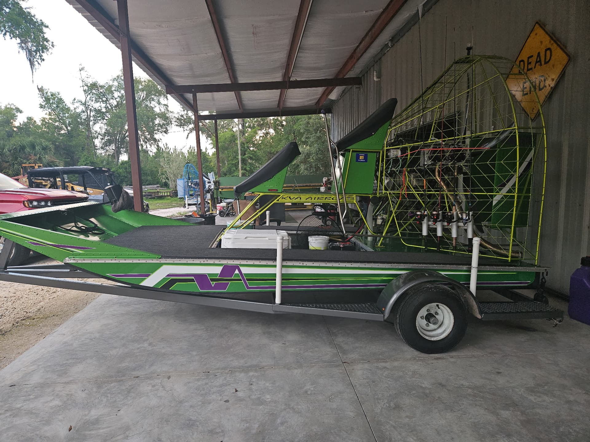

Here’s the scoop. I recently acquired an airboat and had been running big Cypress, with the water level low. what was new Fasco steel flex Bottom Paint with gator glide over it became beat up quick.

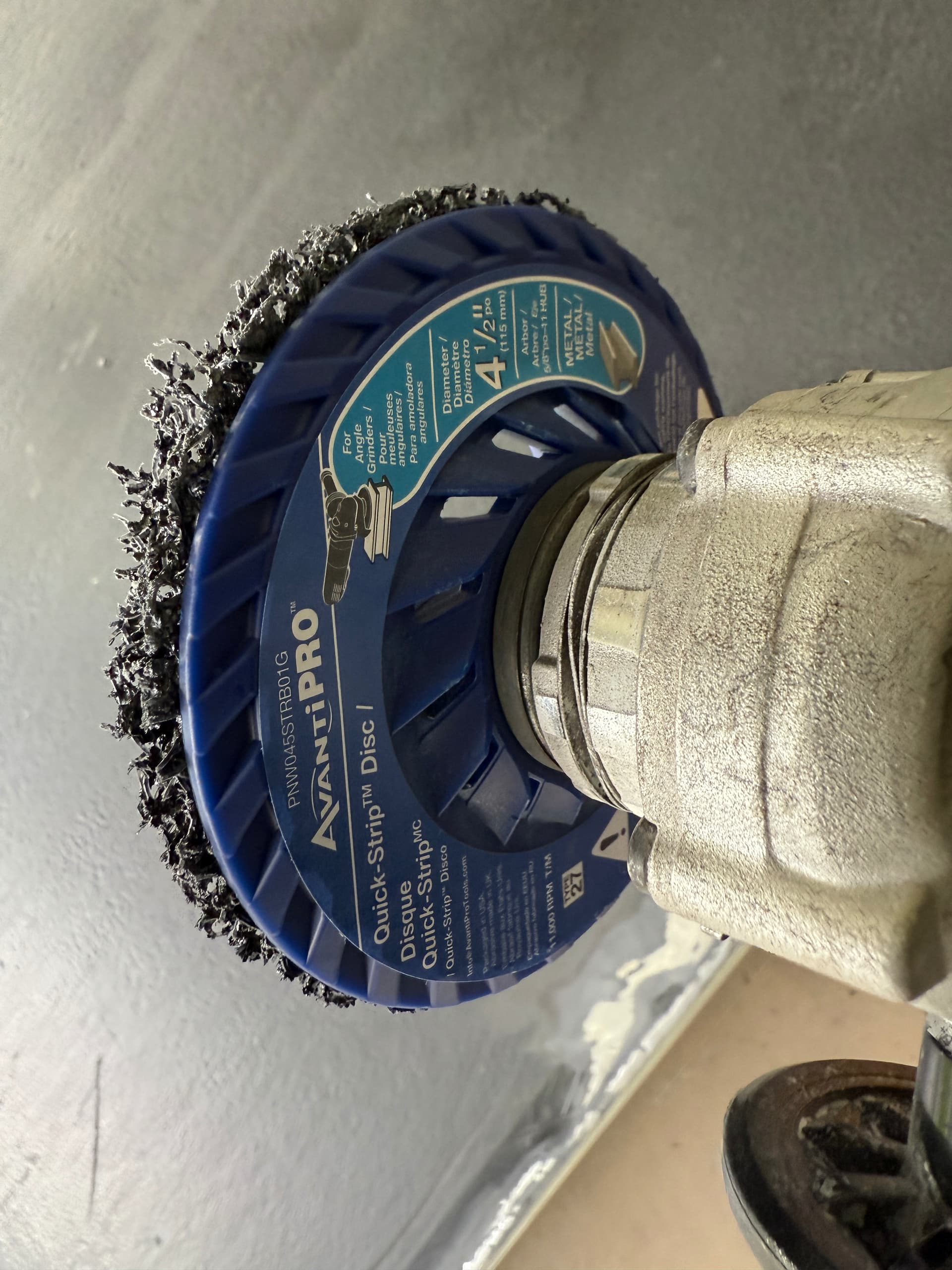

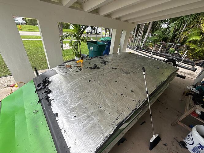

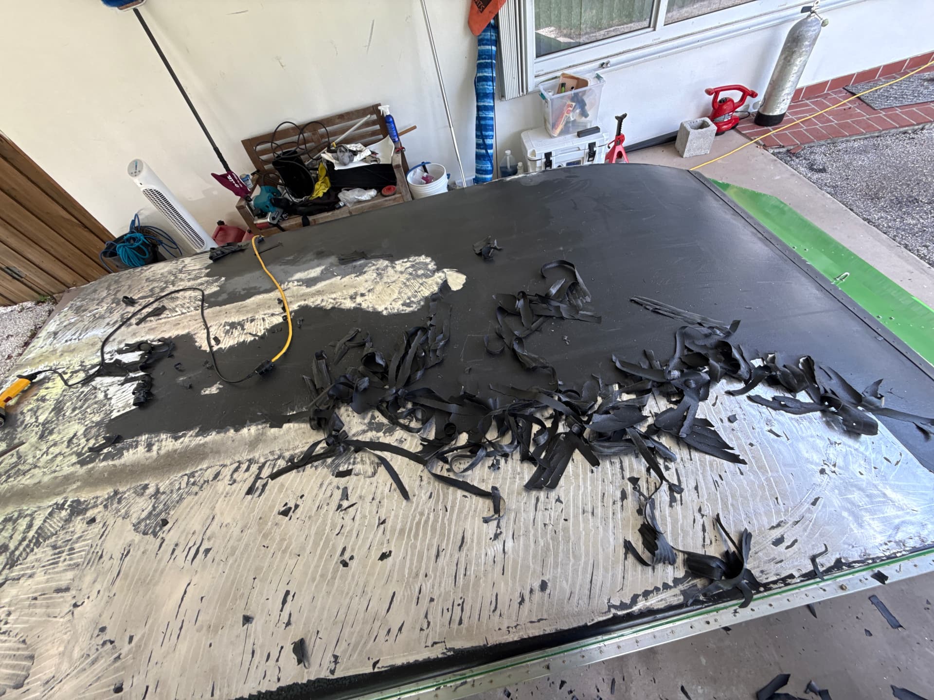

Don’t do things wrong for the first half like I did, trying to chisel off hard epoxy paint from areas that it was stuck on well . Skip straight to what I found to be the most effective way to remove epoxy Bottom Paint. Use a heat gun or three of them zip tied together, heat an area of the epoxy coating and use a 3 inch stainless steel scraper. It comes right off.
So now that you’ve quickly peeled all the Bottom Paint off your aluminum hull you’re going to prepare for new epoxy.

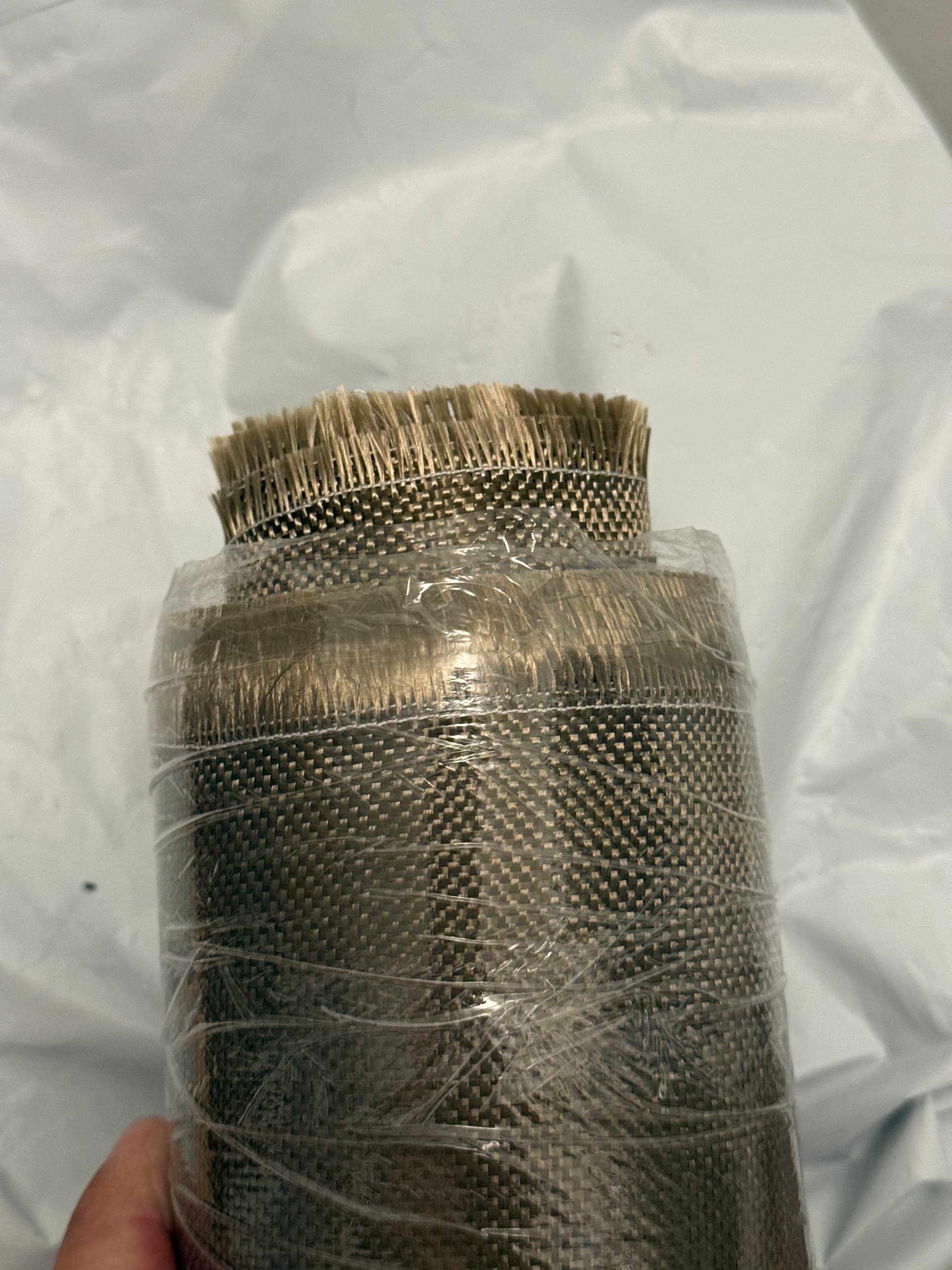

Additional to the epoxy coating. I ordered 12 meters x 1m of basalt cloth 200 GSM (6oz), aluminum etching, which is basically just a mild acid in my case I used on/off and barnacle, buster and a product called Alodine, typically used when painting aluminum airplanes. It is an adhesion promoter, chromate converter. Basically it helps, protect the aluminum and prevents oxidation which does not allow paint/epoxy to stick.

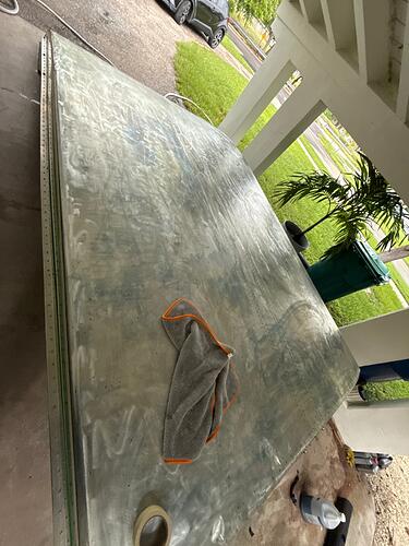

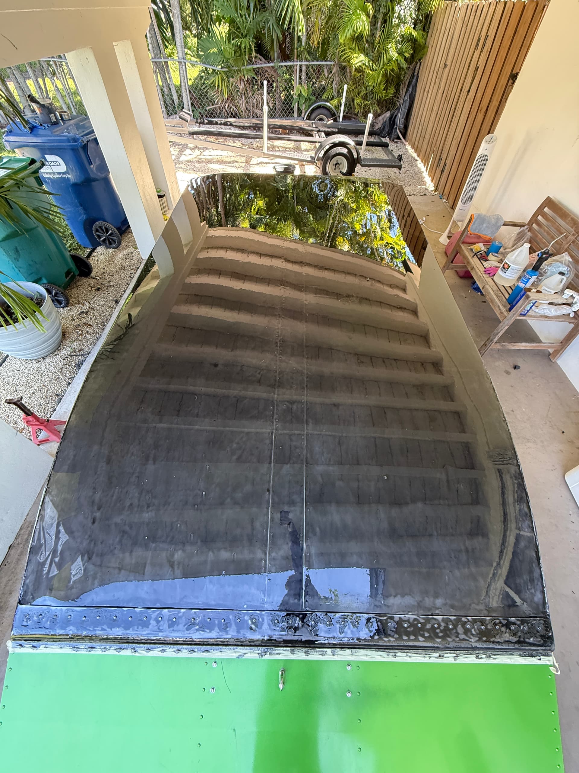

After the epoxy was removed, and I arrived at raw aluminum, I prepped that area with sanding as intended, then washed it twice with acid rinsing that off well and followed up with a treatment of Alodine. the Aldine should turn all of the aluminum a nice gold color, but mine came out kind of blotchy, gold and blue. I tried it again and things did not much change. Best I could gather from researching online is when I used the acid etch I should’ve also used a Scotch-Brite pad,(sanding beforehand was not enough) then basically just poured the Alodine and moved it around. Not pour it and smear it with a rag, really the aluminum should be dipped in this stuff, but I could not exactly dip a boat. From what I can tell it worked fine tho, It just wasn’t pretty.
(sidenote Alodine is nasty stuff, cover yourself up well. technically it should all be re-claimed and disposed of properly)
Now I was working quickly dry and start epoxy, but in typical South Florida fashion storm clouds came in and the rain did not let up. If I was not using Alodine, I would have needed apply acid etch again because oxidation forms quickly on aluminum, the Alodine helps convert the surface and extendeds the window of time to coat. So the next morning at 6 AM I started preparing things to lay down epoxy.

The basalt cloth is approximately 40 inches wide and three layers of this would cover the bottom of the boat with some overlap, as it turned out, I was sent a little extra basalt cloth so that was used as well.)

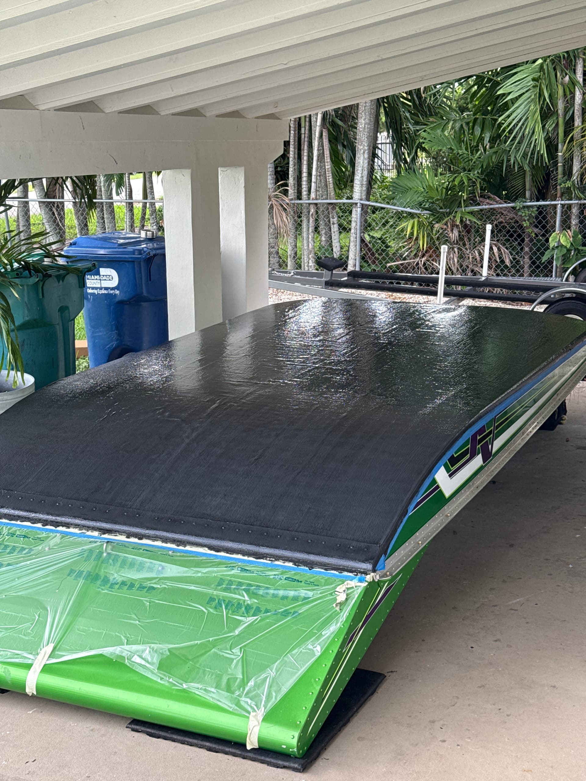

I was hoping that I would be able to put down my final layer of super slick without pigment to see the weave of the basalt cloth but with it being so dark, I decided to mix pigment into the super slick 2000 I had 1 gallon of super slick with an additional pint or so as back up in separate containers. I mixed up 3/4 of the 1 gallon with pigment and spread that around with a roller.
I allowed that to cure/dry to the point where I could still have chemical adhesion and mixed up the remainder of my super slick with some powdered graphite I had poured and rolled that on top.
I gave all of this three days to cure, then flipped over the boat and put my rigging engine, etc., back on then waited an additional day and took it out into big Cypress to test.

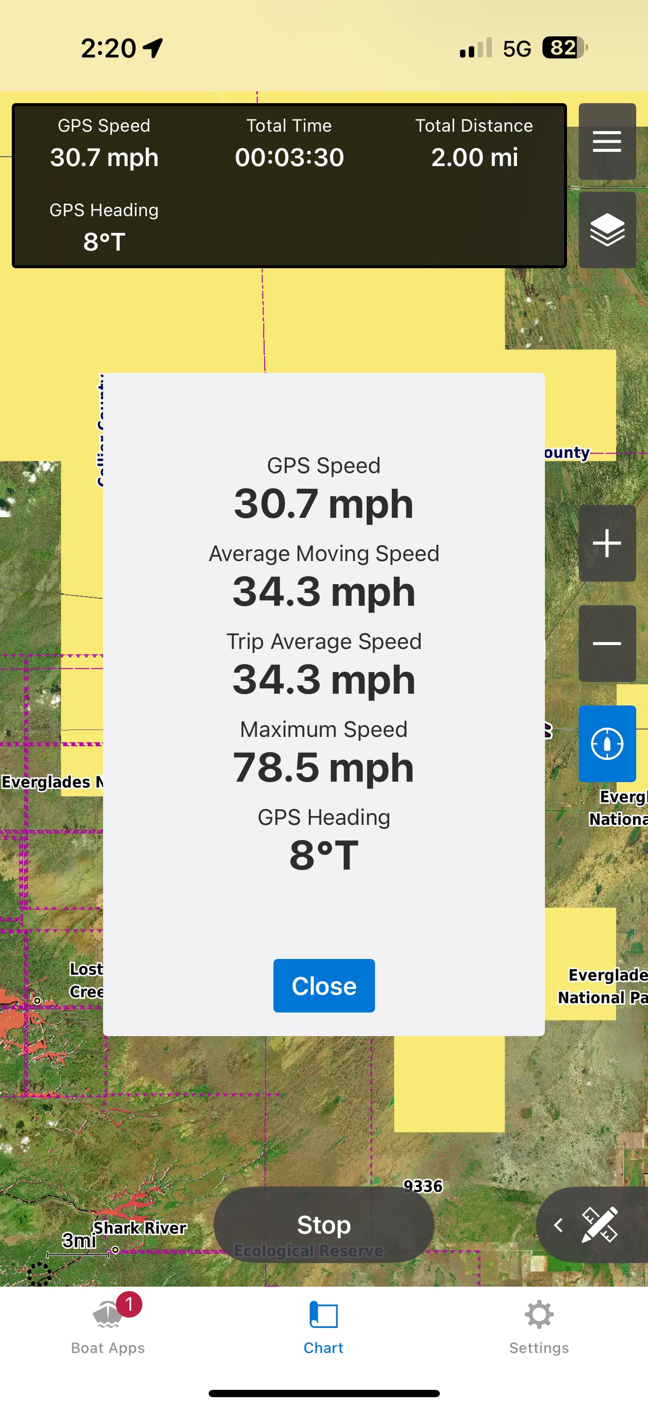

The boat ran well and the Bottom seemed to hold up during testing. I pushed on the boat going 78 miles an hour and no catastrophe.

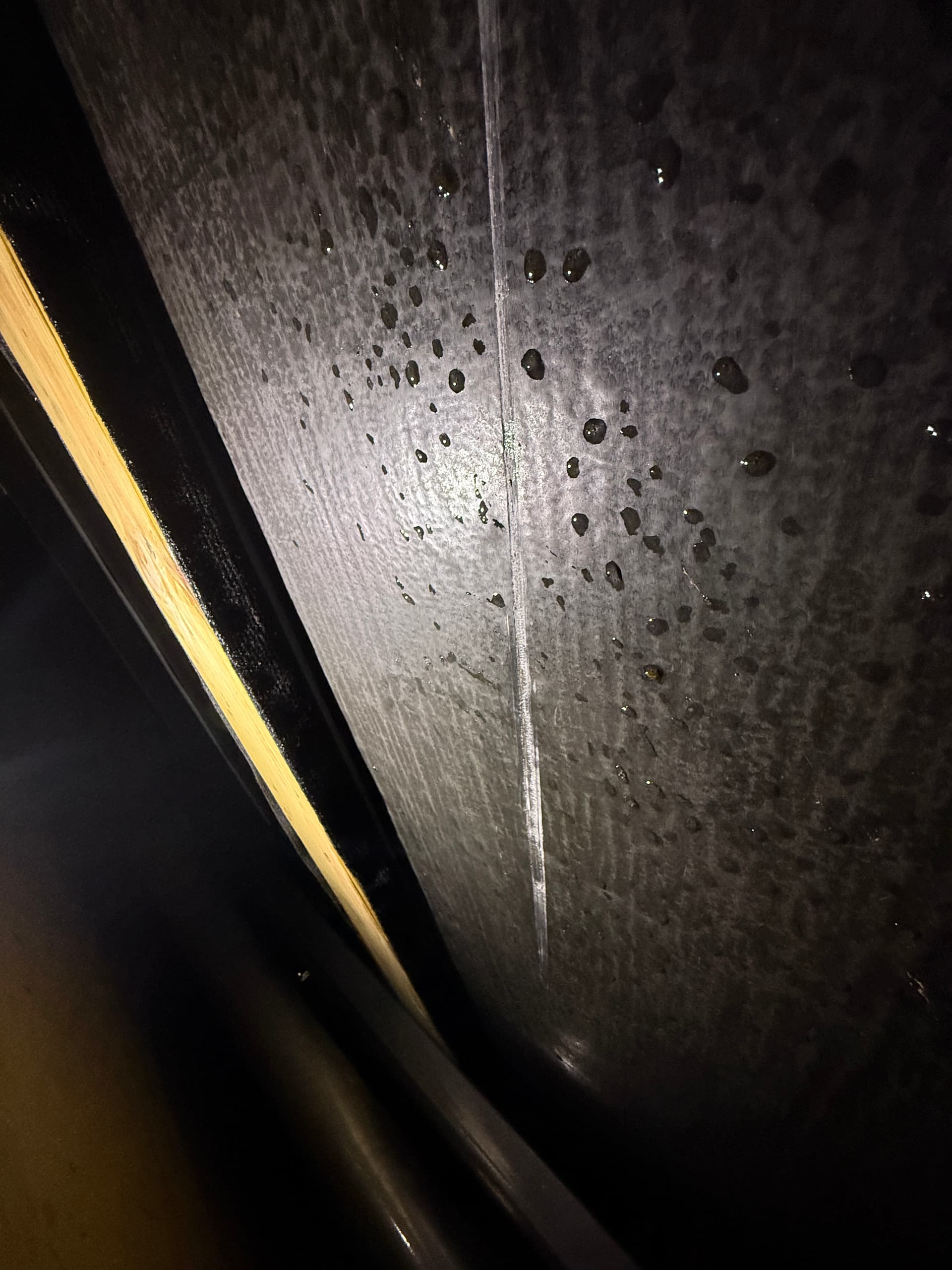

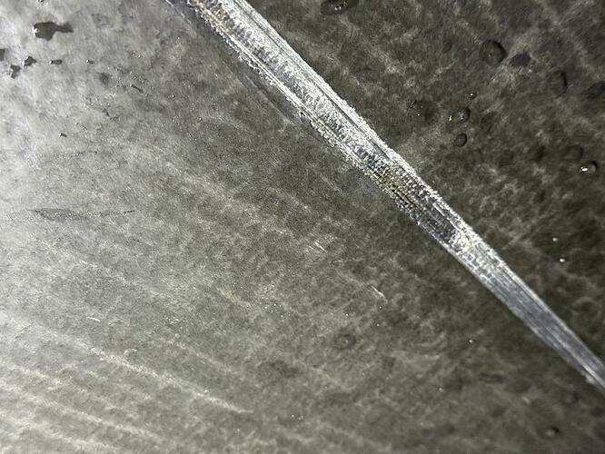

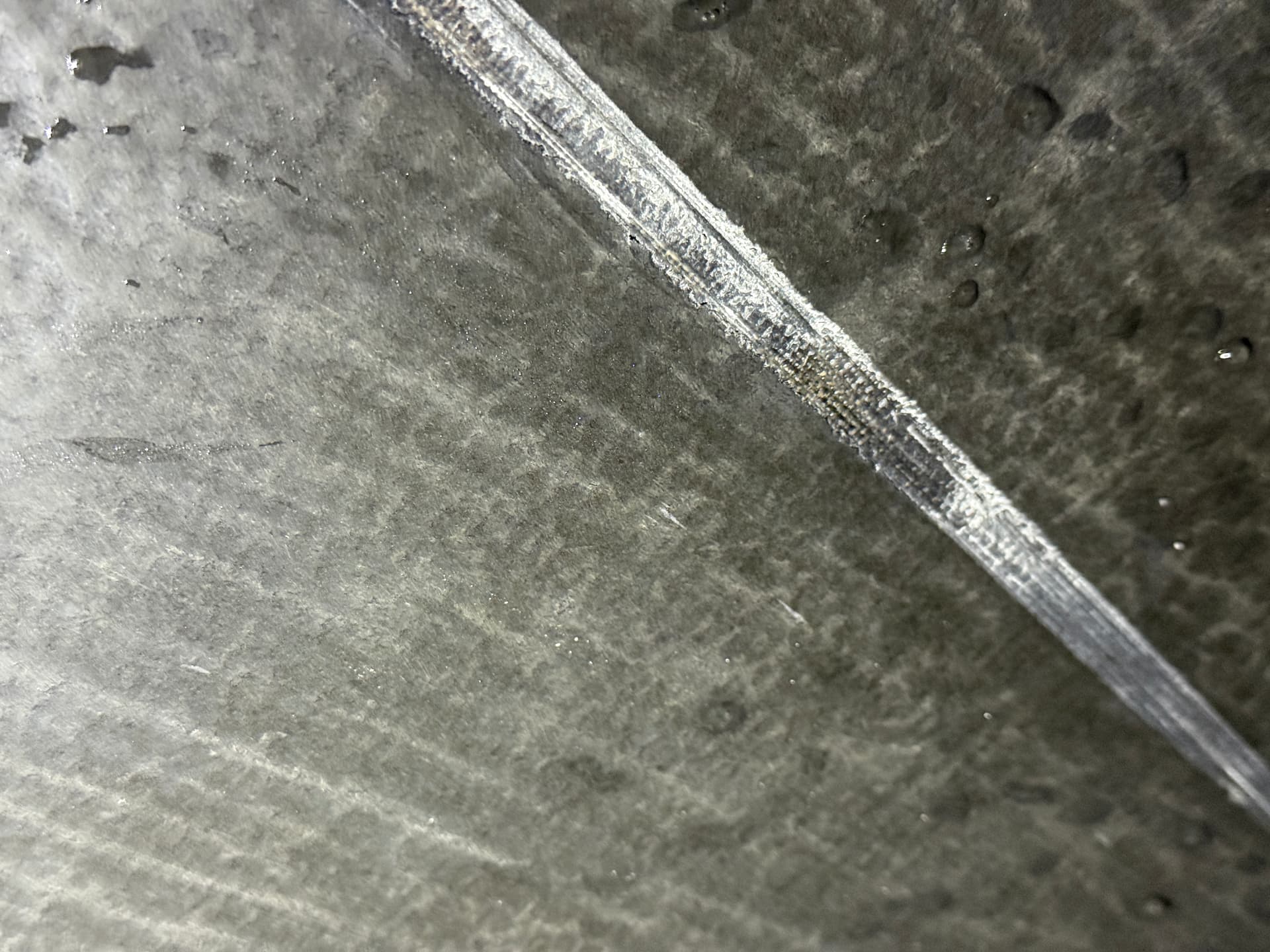

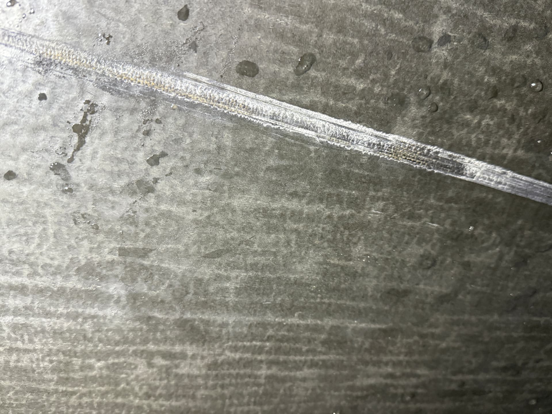

When retrieving the boat at the ramp the side of the bank/ramp has some rocks on it and thought that would be a good test. so as I pulled the boat up to tie off, hitting some rocks slowly with the front so after I was back at home. I looked at these areas in addition to one other area where I must’ve hit a rock. the product(s) were working as intended. I could see the scratches go through my top layer of super slick, contact the bssalt layer and stop there without any chipping. If I had only used super slick, I think the rocks would have gouged through it enough that I would then end up with exposed aluminum again. I still need to see how this works long-term but as of now I’m satisfied with the experiment.
You can just barely see the cloth if you zoom in, the alternative would’ve been aluminum so I think the cloth is working well as a binder
now with these small areas, should I so choose I can hit them with a little sandpaper and roll/brush a fresh coat of super slick over these areas without risking having exposed, aluminum, and water, pushing between the epoxy and aluminum.
