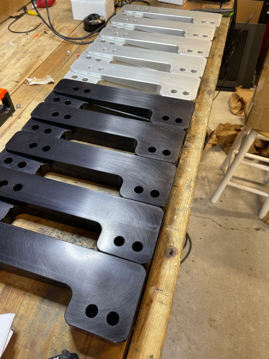

Just received a set of black anodized wedges from HMP. Great quality and finish!
Negative trim transom wedges are now standard equipment on any boat I own going forward. Just there when you need it, and can always be cancelled or overruled with power trim. However, they do add about an inch of setback - which also allows for running with slightly higher motor height.
A word of caution…I added a set of HMP wedges to gain clearance between my cowling and poling platform since the F70 has a larger cowling than my 70TLR and I actually need more positive trim but it stops short with the wedges. If you need wedges to get on plane you really need to look into getting the correct prop. With tabs down you shouldn’t need that much additional negative trim to hop up. I am about to remove them and have my platform modified to clear the cowling and add a step/ back rest to the front.
