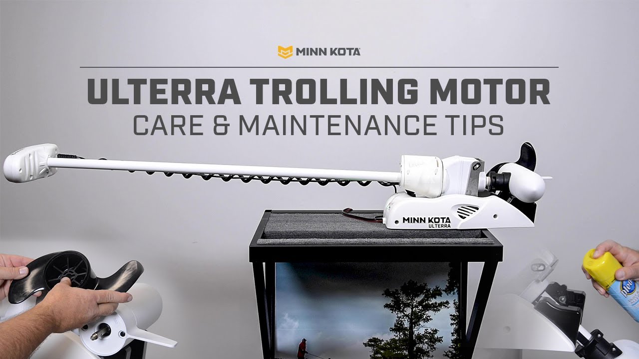

Decided to dedicate a little time this morning to complete preventative maintenance on my 2017 Minn Kota Riptide Ulterra 80. I found the following video from Minn Kota and though “yea, not a bad idea”. So glad I did!
While completing this maintenance inspection I found a cracked part.
