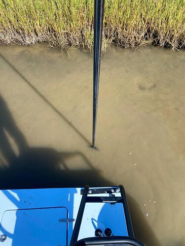

Got out solo last Friday. Was poling along and glided to a stop, so I figured I’d snap a pic of how much water I was in. The glue ring above the joint of the push pole foot is a little under 6 inches. With 100 lbs of sandbags on the front, I wasn’t quite balanced out. With another 50 lbs up front, easily a 5 1/2 inch skiff.
I’m like my @Chris_Morejohn skiff more and more every time I take it out.
Four 25 lb sand bags. EZPZ. No hull slap and when I’m ready to move, I put them on the floor on the port side to balance me out and use less trim tab.

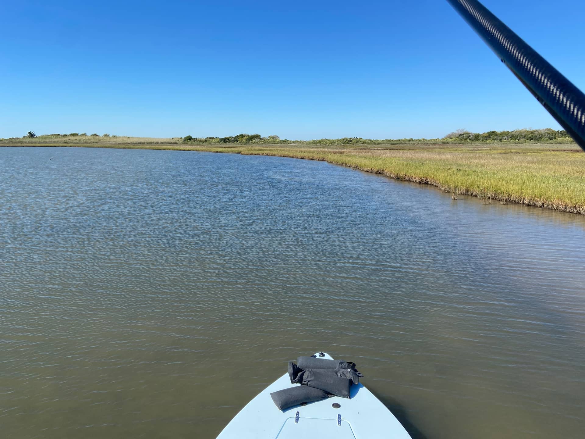

Had a little bit of action, but nothing like some of my friends that were about 15 miles away.

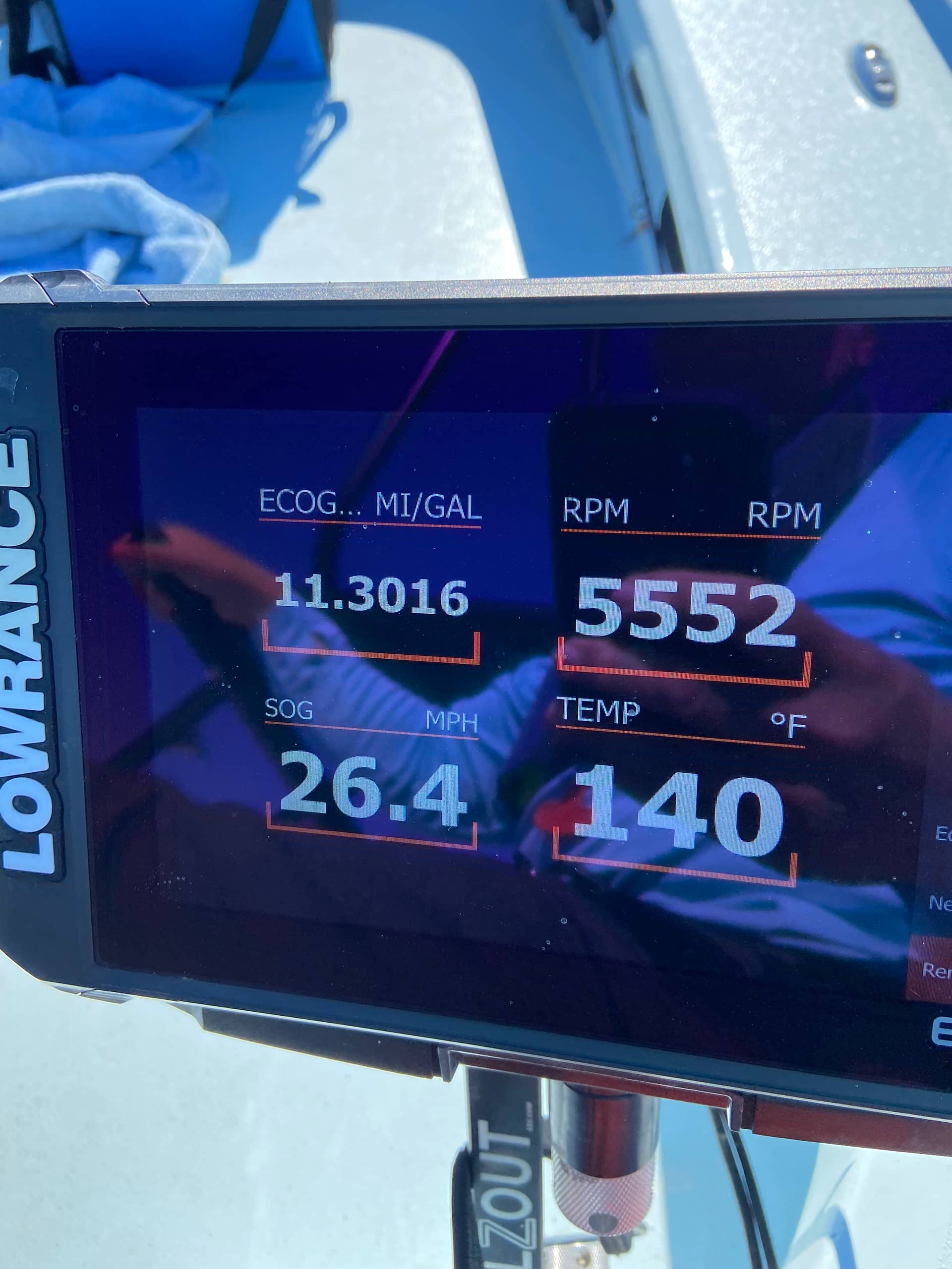

On the way back to the ramp. 30 horse Tohatsu. 11.3 mpg at 26 mph. I was in the sweet spot and just kept it there, but I have hit 30 mph before at the WOT rpm at 6,500 rpms.

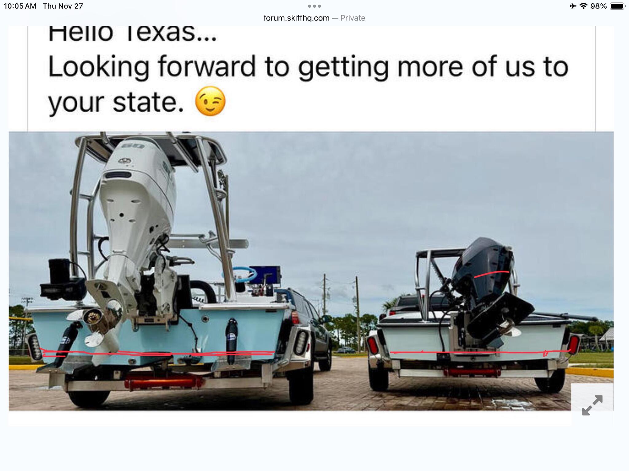

Your Conchfish is the stretch Limo of flats skiffs.

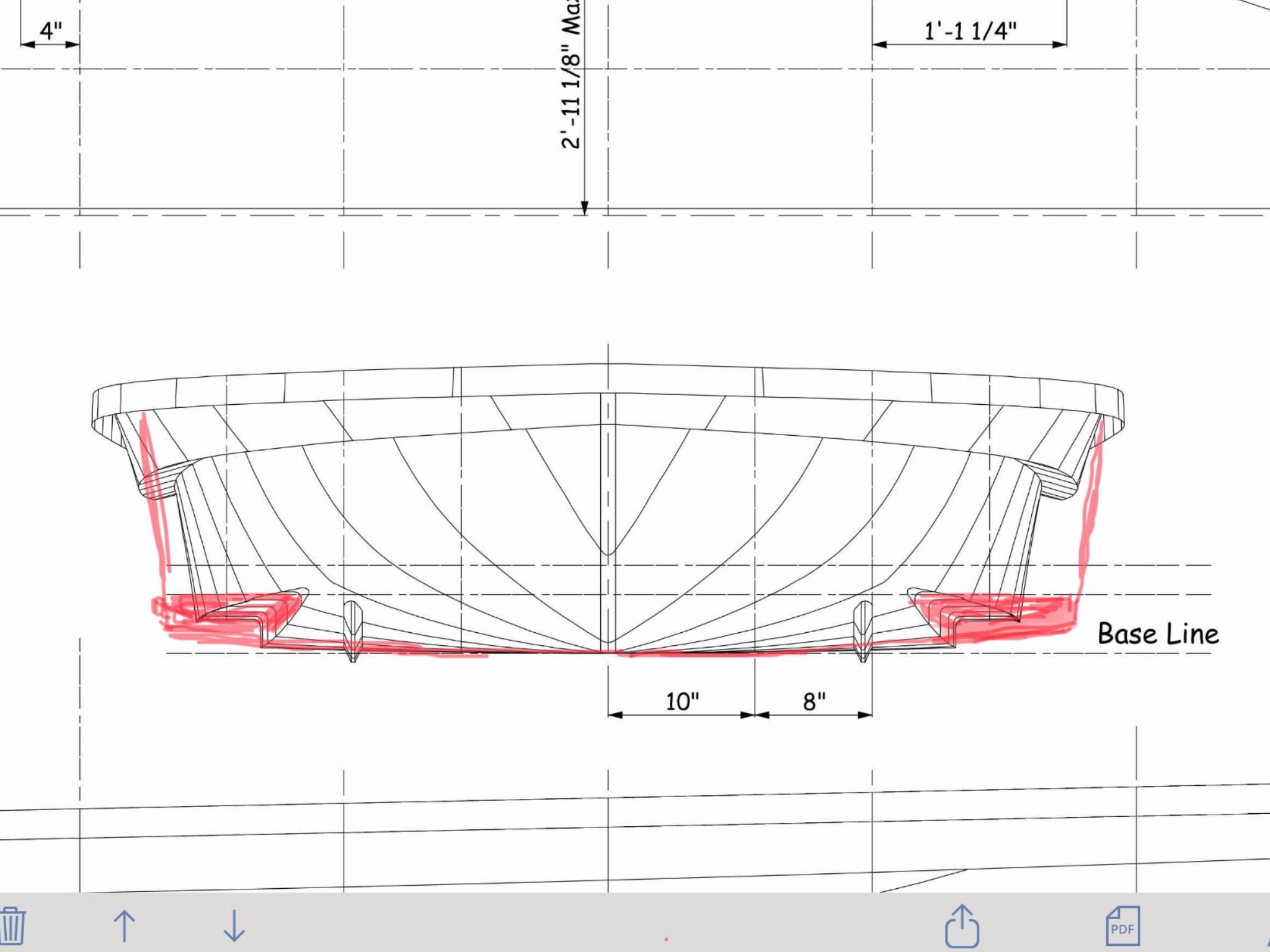

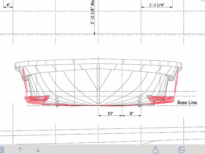

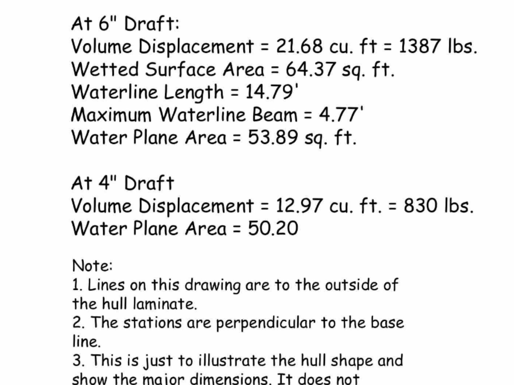

Hope these images help show the folks here how displacement numbers work to get shallowerdraft.
Please excuse my crude drawing and explanation guys but I am guesstimating numbers here because East Cape does not show hull lines drawings to show and explain they’re displacements at each inch of draft as I do sharing all my designs.
I am showing the real numbers here of my Conchfish design that is evolved over 29 years of proven draft numbers of what everyone is looking for….the Holy Grail …4” -+. Happy to see your quest is nearing its end.
I don’t know your true waterline beam but my rough numbers with your possible waterline length I will say you have anywhere from 200+ more lbs of displacement over the Conchfish, Whipray hulls. Your cut down Evos added waterline beam gives way more stability over these two designs for sure.
As everyone knows I am not a fan of conventional lower chines for not being the driest running but I feel they do add to a slight speed edge. You don’t lose any bit of displacement like my inset chines design details do. So that’s a plus in the getting to the 4” number.
This all being said to stay at 3.6”+ draft number everyone has to realize you all will have to lose weight personally, and in your skiff to stay at those numbers.
